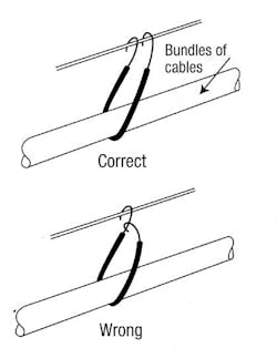

JANUARY’;S PUZZLERAn electric cable bundle was supported by cable hangers. The hooks at the ends of the cable hangers were hooked over the top of a metal strip (see top figure). The electric cables had to be lowered to the ground to provide access to whatever lay behind them. When the cables were returned to their supports, they were put back as shown in the lower part of the figure. This increased the load on the upper hooks. One hook eventually failed, increasing the load on the adjacent hooks. They then failed. A 200-ft. (60 m) length of cables fell, injuring one man. How can we avoid this situation in the future?
Send us your comments, suggestions or solutions for this question by Nov. 29. We’;ll include as many of them as possible in the January 2005 issue. Send visuals, too — a sketch is fine. E-mail us at [email protected] or mail to ProcessPuzzler, Chemical Processing, 555 W. Pierce Rd., Suite 301, Itasca, IL 60143. Fax: (630) 467-1120. Please include your name, title, location and company affiliation in the response.
