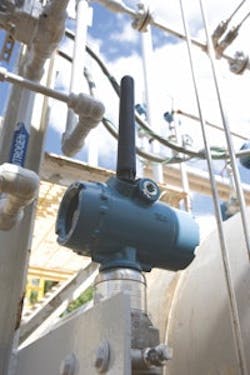

Added Level Instrument
Figure 1.Native WirelessHART devices like this one have an internal power module, avoiding the need to add cabling of any kind.

In such a case, you many need a path to talk to the field device or additional instrumentation. If the skid has a full-scale level device, such as a differential pressure (DP) or a guided-wave radar (GWR) instrument, it may be possible to add a wireless converter. If the transmitter uses 4–20-mA plus HART, you can install a wireless adapter to send the relevant process data to the plant’s WirelessHART network. This need not interfere with the connection to the PLC, so the level transmitter can continue to do its job in terms of process control.
If the level devices on the skid aren’t suitable, you may need to add an entirely new instrument; a good choice usually is a DP or GWR device with native WirelessHART (Figure 1). Other technologies are also adaptable using 4–20-mA-to-WirelessHART adapters. If you have a network in place but it doesn’t have spare capacity, it’s fairly simple and inexpensive to expand it; this almost always offers a cost-effective option.
