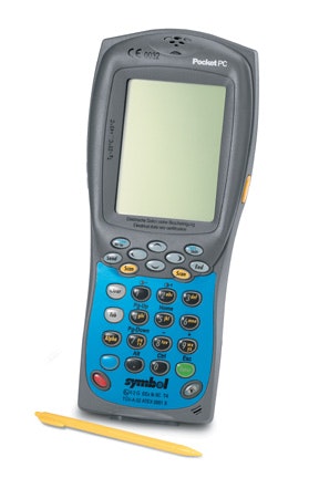

Symbol Technologies' intrinsically safe, handheld terminal.
Eastman has applied the benefits of wireless LAN technology to applications in our warehouses. Eastman partnered with Symbol Technologies to bring an i-Safe (intrinsically safe) version of their popular PDT8146 to market. This handheld terminal runs Microsoft's Pocket PC operating system and has a built-in bar code scanner and wireless LAN. We have written an interface directly into SAP so operators on the warehouse floor can perform inventory movements, receipts and shipments in real time. This has improved accuracy, timeliness and has reduced labor, as we no longer have to track changes on log sheets and retype them into SAP.

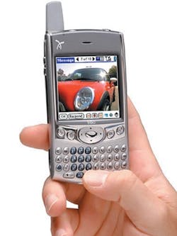

Handspring's Treo 600 PDA/phone.
I take advantage of this in two ways. The new Treo 600 PDA/phone gives me one small, convenient device that that is not only a great phone, but will wirelessly synchronize e-mail, calendar, contacts, notes and tasks. This summer, when I took the Scouts on a traveling summer camp, I got up a few minutes before it was time to wake the boys. During that time, I was able to address any critical needs at work. When I arrived at the office after my week off, I had already answered 85% of my e-mails and deleted them, making the return far less hectic. Eastman uses Pylon software from iAnywhere to synchronize with MS Exchange.
