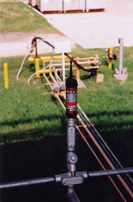

A low-power wireless transmitter/receiver is mounted near field storage tanks.

Akzo Nobel control systems specialist Marc Ayala inspects a wireless transmitter/receiver connected to DeltaV I/O modules.

Akzo Nobel cautiously considered using wireless technology. Ayala, who had tested a wireless technology that did not work at distances of more than a few hundred feet and experienced serious interference problems from the radio towers adjacent to the plant, understands how reliability ," as well as security ," concerns have impeded the technology's acceptance. He took another look at wireless, though, when the plant needed to add two temperature measurements for monitoring and keeping historical data on the temperature of a raw material. The material is stored in an awkwardly located storage tank to which it would be difficult and costly to route wires.
After extensive research, site visits and discussions, Akzo Nobel installed the HS-900 wireless monitoring system, based on ISM (Industrial, Scientific and Medical) spread-spectrum bands, from OMNEX Control Systems, Port Coquitlam, British Columbia, Canada. The 900-megahertz-band Frequency Hopping Spread Spectrum-based transmitter/receiver set can provide 4-20mA current to the temperature transmitter. It can be mounted in Class I, Division II, Groups A/B/C/D environments and supports Hart communications. Each transmitter/ receiver pair uses digitally encrypted communications to maintain security.
Ayala's team pondered whether to interconnect the OMNEX system with DeltaV. That approach, Ayala says, was more cost-effective than pulling wires and running new conduit. In fact, his team estimated that labor costs to prepare the path for wires alone would have been 10 times the price of a wireless transmitter/receiver.
In general, the use of wireless technology for process monitoring and control purposes has been limited to supervisory control and data acquisition applications that cover large distances.
Nevertheless, Ayala's team had no trouble integrating the OMNEX system with its input cards and setting it up. The effort was worthwhile.
"The wireless integration to our DeltaV has enabled alarming, trip points and intercommunications from the actual wireless in the field, which is over 1,300 feet away," says Ayala.
The plant has installed 10 receiver/ transmitter sets for temperature monitoring and, in one application, for closed-loop control on a slow-acting temperature control loop using steam.
