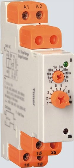

Automatic Timing & Controls, a division of the Marsh Bellofram Group of Companies, introduced the Model 175SO-110, a highly compact, ON-delay DIN rail mount industrial timer designed to provide high-accuracy timing control within OEM and industrial applications, particularly where installation space may be at a premium.
With a low-profile, space saving outer housing design measuring 17.5 millimeters, the Model 175SO-110 single-mode industrial timer features a 5 amp SPDT relay output contact configuration, LED indication and ten user-selectable time ranges from 0.1 seconds up to three hours. The timers feature a 110 VAC (50 or 60 Hz) supply voltage. The unit is easily configured for time range and scale setting via its front facing knobs. The Model 175SO-110 is UL listed and CE certified.
The Automatic Timing & Controls Model 175SO-110 is suitable for OEM equipment, packaging and plastics machinery, industrial equipment control, material handling, conveyor systems control, motor and pump control, and various process industry applications. Units may be used as lower-profile drop-in replacements for virtually any DIN rail mount 110 VAC ON-delay single-mode industrial timing applications.
