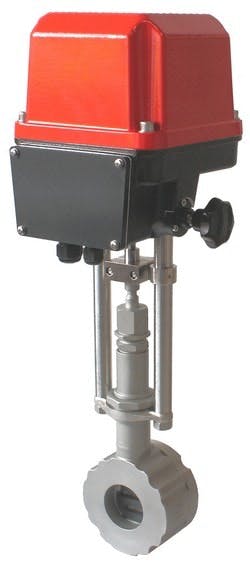

The new motorized actuation from Schubert & Salzer Control Systems has overcome these drawbacks. The actuation of the 2030 series, comprising an electric stepping motor, a flexible coupling, a gearbox and stroke detection, was designed and manufactured to a high degree of precision. The stepping motor defines 400 steps per revolution. Every part of the gear box is made of steel, which enables a long service life. Each step of the motor results in a displacement of 1.5 μm. At the same time, the new 2030 actuator can achieve positioning speeds of up to 1.3 mm/sec.
The stroke detection for feeding back the position consists of metal guides, a linear potentiometer and limit switches with Hall sensors. By using a 12-bit AC/DC converter and a special interpolation process, the position of the stroke can be detected precisely with a resolution of about 3 µm. Although the sliding gate valves 8038 series combined with this 2030 actuator has a stroke of only 6 mm, the resolution and the level of control are very high, taking 4.5 seconds to open or close.
