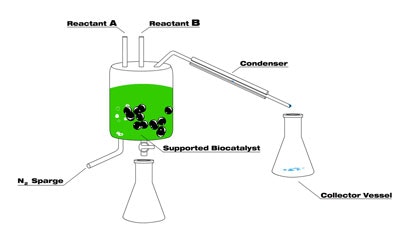

One of the reasons behind Eastman's success is its breakthrough green biocatalytic process that already has won a 2009 Presidential Green Chemistry Challenge Award.
The new process uses enzymes and closely controlled conditions to make esters, eliminating the high temperature and strong acids traditionally required.

Eastman now has synthesized a variety of esters using enzymes at mild temperatures. Esterifications are driven to high conversion by removing co-product, usually water from esterification of an acid or a lower alcohol from transesterification of an ester. Filtration easily removes the immobilized enzyme, e.g., lipase. Specificity of the enzymatic conversions and relatively low reaction temperatures minimize formation of byproducts (some of which could affect color and odor), increase yield and cut energy consumption. The process reportedly can save more than 10 liters of organic solvent per kilogram of product.

New Route To Esters
Figure 1. In the lab, the enzyme-based process requires just one step. Source: Eastman Chemicals.
"We have achieved an essentially one-step process in the laboratory (Figure 1)," said Clendennen, adding that while further commercial development depends on demand market confidence is building now. Once a decision is made, it would take about 18 months for commercial production to begin, she believes.
