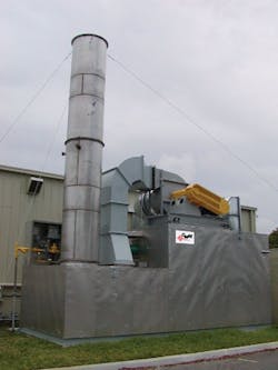

Figure 1. Bring on the Heat
RTOs use very high temperatures to promote a chemical reaction of the VOCs/HAPs with oxygen, offering a destruction efficiency of more than 98 percent.

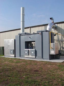

Figure 2. Catalytic Conversion
Catalytic oxidizers operate at lower temperatures than RTOs, typically resulting in lower energy requirements, and provide a VOC/HAP destruction efficiency of more than 98 percent.
