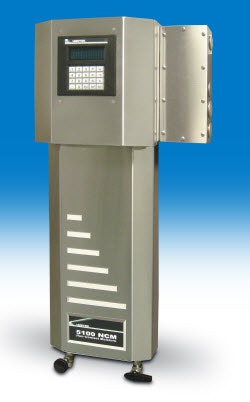

AMETEK Process Instruments has broadened its line of Model 5100 Series gas analyzers to include a portable version. The Model 5100 Portable, based on Tunable Diode Laser Absorption Spectroscopy (TDLAS), provides superior analyte specificity, sensitivity and measurement speed of response.
The initial version of the 5100 Portable is configured for the measurement of H2O in Natural gas, bulk gases and hydrocarbon gas streams. Additional analytes will include O2, CO2, CO and CH4 . The hand-held, battery-powered device provides approximately 8 hours of use before requiring a recharge. Other features include compact, fully enclosed optics, sample handling, on-board reference cell for laser line lock, and all digital signal processing. Its laser module has an internal Thermal Electric Cooler (Each unit is factory calibrated. The laser wavelength stability and non-contact nature of the measurement eliminate the need for field adjustments.
