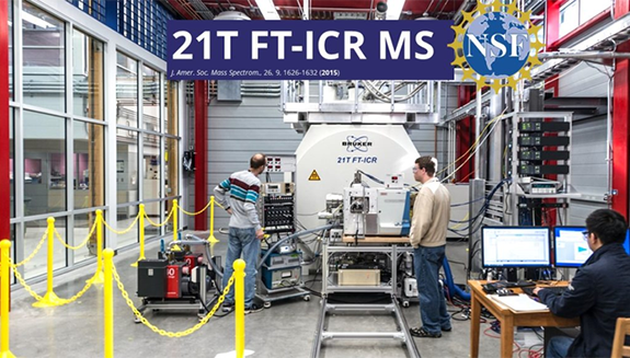

Now, researchers at Colorado State University (CSU), Fort Collins, Colo., are using a powerful chemical analysis tool — the 21 Tesla Fourier-transform ion cyclotron resonance mass spectrometer (21T FT-ICR MS) in the NSF-funded National High Magnetic Field Laboratory (MagLab) at CSU’s Department of Soil and Crop Sciences — to help unravel the complexities of PFAS. CSU says the 21T FT-ICR MS can differentiate between individual chemical compounds more accurately than any other instrument.
“It’s powerful enough to be able to see all of these different PFAS molecules, but it’s also powerful enough to pick them out of environmental samples that contain many thousands of natural compounds,” says Robert Young, a CSU alumnus and director of the Chemical Analysis and Instrumentation Laboratory at New Mexico State University, Las Cruces, N.M.
