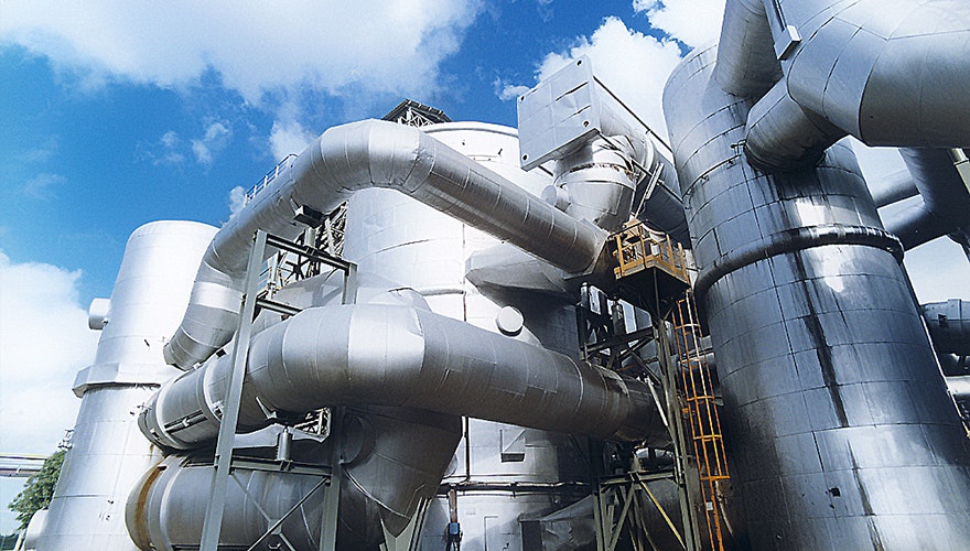

1660318492827 Heroadsorptiontower
Emissions: Absorption Tower Provides Important Benefits
