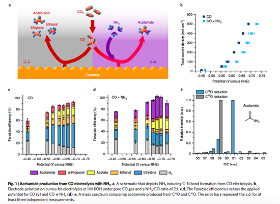

Figure 1. Schematic depicts ammonia inducing carbon-nitrogen bond formation from CO electrolysis. Source: Feng Jiao, University of Delaware.
“The important insights obtained from this work include the identification of ketene as a key intermediate in copper-catalyzed carbon monoxide reduction reaction and the possibility to form carbon-heteroatom bonds by co-feeding a nucleophilic agent with carbon monoxide. The collaboration with Caltech further enabled us to establish a detailed reaction mechanism, a critical knowledge towards rational design of advanced catalysts. For example, we can tune the property of the catalyst and make it more favorable for one reaction pathway than the other. Such a catalyst design requires us to know which intermediate holds the key for product selectivity,” he adds.
The team performed an 8-hr electrolysis test to determine the stability of the copper catalyst and susceptibility to poisoning. Results showed no loss of catalyst activity and selectivity. “We also examined the structural stability of the catalyst … Of course, more studies will be required to investigate catalyst stability at a much longer time scale for practical applications,” admits Jiao. “We also haven’t tested other potential contaminants that could be present in common carbon monoxide or carbon dioxide sources. This will be something for future studies,” he adds.
The researchers reported in a paper in Nature Chemistry acetamide selectivity of nearly 40%. “The work we just published is the first demonstration of CN-bond formation in electro-reduction of carbon monoxide in the presence of ammonia (or amine). There is plenty room to improve the selectivity, which is important to minimize product separation costs,” notes Jiao.
