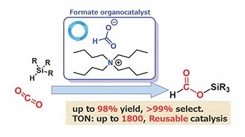

Catalytic Hydrosilylation
Figure 1. Formate salts serve as active and selective catalysts for the hydrosilylation of CO2. Source: Ken Motokura.
