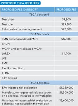

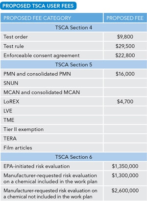

Table 1 summarizes the proposed fee amounts.
Proposed TSCA User Fees
Table 1. The EPA’s proposed fee amounts will help the agency support the TSCA program.
