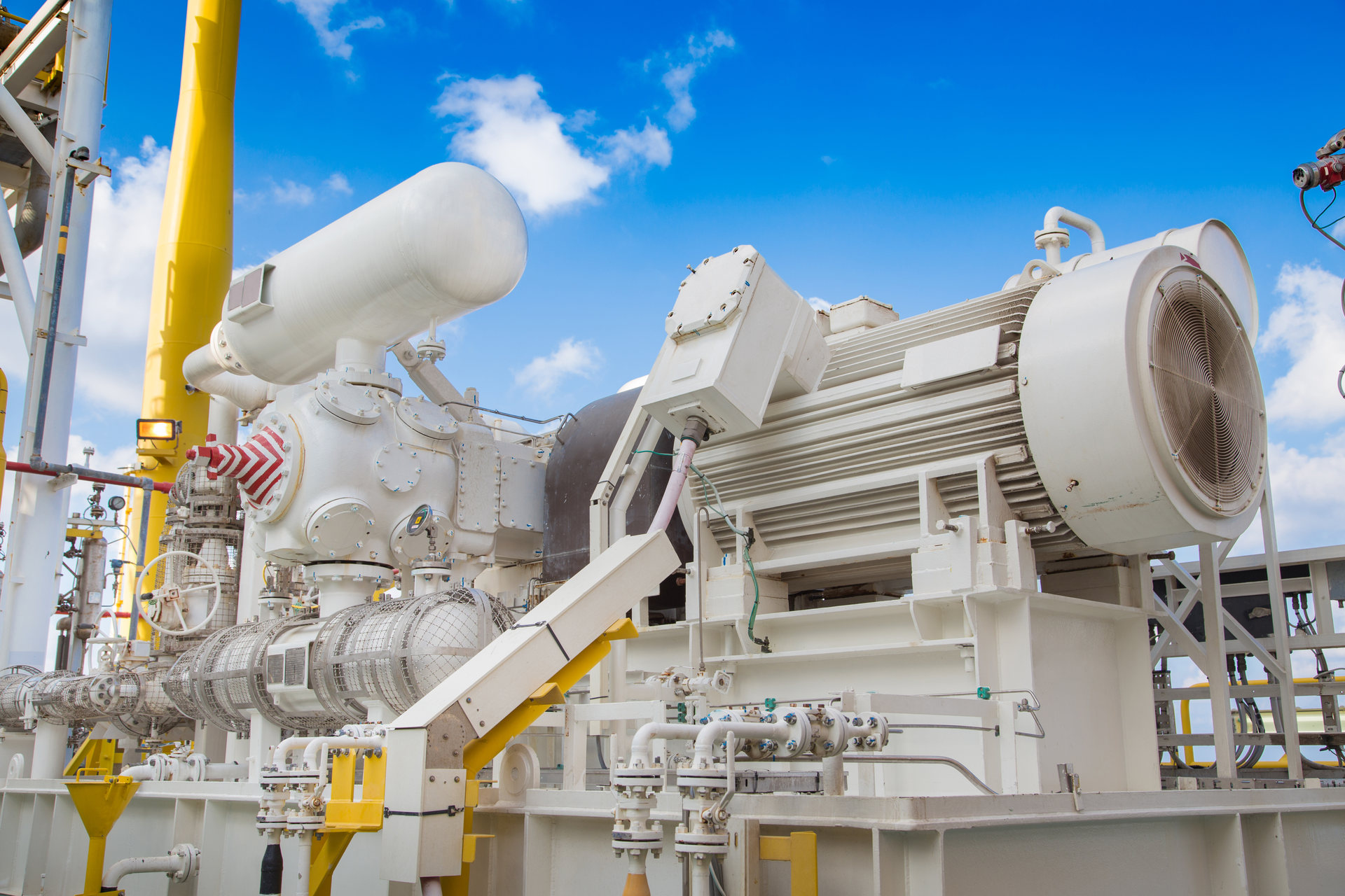

Figure 1 shows a vastly simplified view of the final system. One point that immediately leaps out is the two knockout drums downstream of the compressor after-cooler. This looks odd. Typically, if a drum is sized correctly, a second one downstream is not required. So why use two?
Different elements of gas recovery have different risks. The waste gas recovery has liquids or freezing risks present from two sources. The first source is process conditions. The second source is heat-loss-induced condensation.
Process condition risk comes from the recovered dry purge gases mixing with the compressed waste gas. Joule-Thompson cooling on the purge gas entering was sufficient to cause local freezing. Heating the mixing area mitigated this. The second element was bulk liquid condensation after the mixing. Regretfully, this was a realistic possibility. However, this only occurred when air temperatures were very high. The high air temperatures caused elevated process temperatures out of X-2. Higher X-2 temperatures left more water vapor in the gas at the mix point. With these high exterior temperatures, condensation in the line and fuel gas system does not occur – so it’s sufficient to have a knock drum (V-3) for liquid removal.
Drum V-2 serves a different purpose. V-2 protects against condensation caused by cold air temperatures. If only V-3 is present, gas entering the fuel system is always saturated. If the fuel gas piping cools off, condensation occurs. However, if the water is removed at V-2, it is removed from a smaller gas flow, cold temperature and higher pressure. Then it is depressurized and diluted with the dry purge gas. It is possible to create a gas to the fuel gas system with a < 32°F dew point with this configuration.
Literally, thousands of cases of feed rates, temperatures, pressures and compositions, along with different environmental conditions, were evaluated. Different limits were identified, including adding hydrocarbon condensation and oxygen contamination. The figure shows some very simplified elements of the final unit. The overall configuration does have some weak points. The shutdown cases were projected to occur < 1% of the days during the year. Under these truly extreme conditions, the unit shuts down until operator intervention starts it up again.
