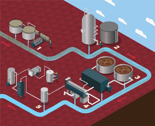

System Schematic
Figure 1. Refinery relies on five treatment stages for its wastewater.

Multistage System
The WIP design features five treatment stages (Figure 1) and uses a range of SUEZ technologies.
Stage 1 — Wastewater tanks and oily water separators. Wastewater initially goes to holding tanks where oil and water are separated by gravity. Floating oil is skimmed from the top of the wastewater and subsequently reprocessed within the refinery. Wastewater then passes to another tank where sediment and oily sludge sink to the bottom. The oil is sent back to the refinery for reprocessing while the sludge is removed and disposed of safely.

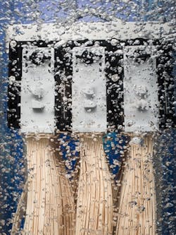

Ultrafiltration
Figure 2. Following treatment in a membrane bioreactor, water goes to hollow-fiber membranes.
Stage 2 — Dissolved gas flotation unit. Wastewater continues to stage 2 — a SUEZ Poseidon dissolved gas flotation unit. Here, microscopic nitrogen bubbles pumped into the wastewater bind to suspended oil particles. The bubbles cause the remaining oil particles to float to the surface where they are removed for reprocessing in the refinery. This stage uses SUEZ’s PolyFloc AE1701 chemistry as a flocculant.
Stages 3 and 4 — Membrane bioreactor (MBR) and centrifuge. Following separation, the wastewater goes to an MBR. First, biological treatment breaks down VOCs and ammonia in the water. Then, the water is filtered using SUEZ’s ZeeWeed 500 ultrafiltration hollow-fiber membranes (Figure 2). This combined treatment creates a permeate. Stage 3 utilizes SUEZ’s BioPlus BA2970 and BioPlus BA3900 chemistry for biological seeding and bioaugmentation in the biological reactor, and FoamTrol AF3031 for foam control there.
Stage 4 consists of a centrifuge to separate the bioreactor’s excess biomass, with bacteria then returned to the bioreactor. A small amount of water also is extracted and reprocessed; the leftover solid biomass is disposed of safely. SUEZ’s Novus CE2655 chemistry serves as a flocculant in the centrifuge.
Stage 5 — Demineralization plant. The permeate from stage 3 largely is free of organics, ammonia, nitrites, nitrate and other impurities. It undergoes further treatment in a demineralization plant in preparation for steam production. The plant features SUEZ’s High pH RO system, which consists of ion exchange units for hardness reduction and a decarbonator to remove alkalinity and carbon dioxide. High pH RO is unique in its ability to effectively run at a very high recovery, under high organic loading, without fouling or frequent cleaning.
This stage prepares the recycled water for steam production by removing high levels of dissolved solids such as calcium, magnesium, chlorides and sulfates. Following treatment, the permeate takes a second pass through another RO unit to polish the water. Finally, a mixed-bed ion exchanger eliminates undesirable ions to produce ultrapure water suitable for steam production. Figure 3 shows the wastewater before and after treatment.
