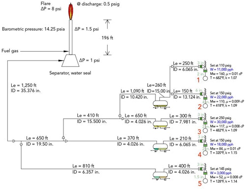

We are investigating whether we can increase our refinery capacity by about 15%. I’ve been told not to worry too much about the vent system. However, I have some concerns, especially because all the pressure safety valves (PSVs) are conventional and some of the scenarios I am looking at involve more mixed-phase flow (see Figure 1). A model of the vent shows that all PSVs have backpressure ratios less than 10%, although valve 2 is close at about 9%. Also, some of the steam heat tracing and the insulation on the vent to the knockout drums haven’t been inspected in some time. Should we be concerned?
Vent System
Figure 1. An increased amount of mixed-phase flow occurs in several potential scenarios.
