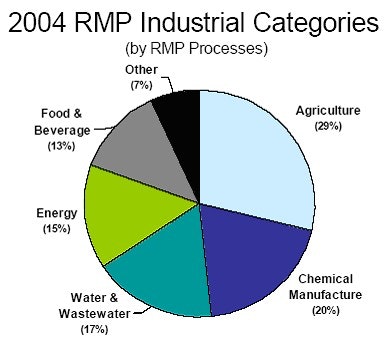

Universe of regulated facilities. Both S. 2145 and H.R. 5695 and DHS’s independent efforts start with sites covered by the U.S. Environmental Protection Agency’s Risk Management Plan (RMP), 40 CFR Part 68. This list includes more than 14,500 stationary sources, some of which pose questionable homeland security threats or consequences. However, chemical manufacturing makes up only about 20% of RMP regulated processes. The rest are agriculture (29%), water and wastewater treatment (17%), energy (15%) and food and beverage (13%) sites (Figure 1).
Figure 1. Five-step methodology begins with asset characterization and finishes with countermeasure analysis.
This RMP list would have to be rationalized, with the DHS secretary setting criteria for designating a facility as a “chemical source” based on risk. Other chemical sources, such as those supplying critical government facilities or dealing with chemicals not covered by the RMP rule, could be added.
