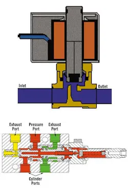

    Flow path within the valve also can change the CV value (see Fig. 1). A straighter, more direct path means that the medium will have fewer fluid stresses applied to it as it passes through the valve. A tortuous (or convoluted) path will have the opposite effect. In fact, two solenoid valves that are the same in every way except internal construction and flow path can have completely different CV ratings.
    Figure 1. Flow Path Determines Rate
    Flow rate in solenoid valves can be affected by a multitude of factors, including internal construction. If a valve's flow path is uncomplicated (top), the medium will flow through it without stress. A tortuous flow path (bottom), as with this five-port valve, will result in a lower flow rate due to greater stress on the medium as it travels through the valve.

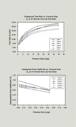

    Finally, consider the issues that arise for a potential end user trying to choose a new solenoid valve. These equations' non-dimensional views of valves' capabilities can result in incorrect information. Manufacturers can test a valve at a given pressure drop to determine the flow rate at a variety of data points, then plug these into any one of the above-mentioned empirical equations of their choosing to determine a coefficient. This coefficient may not describe the valve in a multi-dimensional way. Take the same valve and calculate different coefficients using the different methods and you could get different, less flattering CV values. A lot of calculations are averaged. It even is possible to rerun tests and calculations until the most favorable numbers are gleaned. Figure 2 demonstrates how even valves with the same nominal CV values might actually prove to have very different flow rates. The valves were made by different manufacturers, noted in the graphs by MFR X and MFR Y.
    Figure 2. Big Differences For 0.75Cv Solenoids
    Plotted above are flow rate and compressible flow coefficients vs. pressure drop for various valves at 0.75Cv. The valves were made by different manufacturers (designated here as MFR X and Y).
