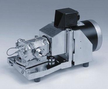

One company poised to take advantage of this trend is Ivek Corp., North Springfield, Vt., which provides pumps and metering systems for liter/min to nanoliter/min ranges, in applications such as pharmaceutical production, food processing and lubrication systems. The company's core product, explains Frank Dimaggio, sales VP, is a reciprocating piston pump, powered by a stepper motor. The piston and its associated chamber are constructed of alumina or zirconia ceramics. The sealless piston pump's components are machined to within 10 millionths of an inch, and get sufficient lubrication from the fluid being pumped so that no other lubrication is needed, says Dimaggio. Using ceramics minimizes fouling while enabling easier cleaning, he adds. The all-digital controls allow for repeatability of 0.1 percent and comparable accuracy. System pressure is limited to around 250 psig to prevent damage to the ceramics.

Split-case pump for metering fluids at rates of up to 2L/min. features a pump module containing precisely machined ceramic parts.
Source: IVEK Corp.
