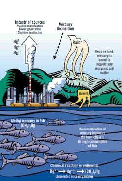

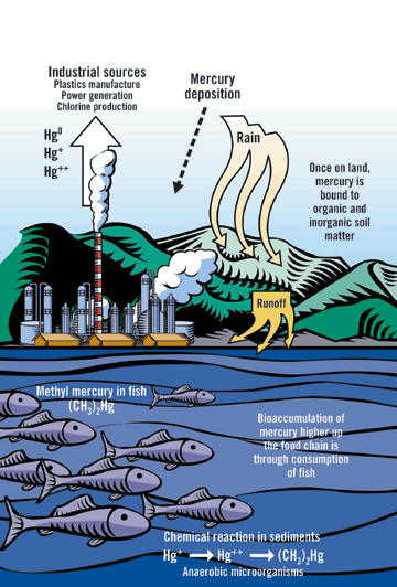

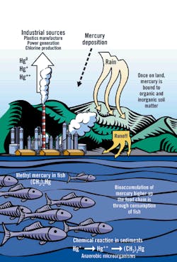

Why is mercury in wastewater such a problem, and why is it more likely to arouse regulatory scrutiny now than it did in years past? Appreciation of chemistry and toxicology and improvements in laboratory techniques all are driving mercury to a higher profile and pushing wastewater standards to tougher levels.
The chemical fate of mercury in nature truly is unfortunate. Most other water pollutants become diluted in the receiving water and then become assimilated through natural processes that gradually render the pollutants harmless.
For example, if dissolved hydrocarbons are present at acceptable levels in an industrial effluent, they quickly become diluted to a lower concentration in the receiving water and then become consumed as a food source by microorganisms. Through the action of the microorganisms, the hydrocarbons are broken down into carbon dioxide and water. The combination of dispersion and biological action, therefore, eliminates the hydrocarbons from the environment.
Mercury is different. Unlike most other pollutants, mercury is both persistent and bioaccumulative. Because mercury is an element, it cannot be broken down into innocuous components. In fact, microorganisms convert dissolved mercury into methylmercury, an organic compound that is more active and toxic biologically than is the original metal.
Once methylmercury enters the food chain, it bioaccumulates and bioconcentrates. As a result, the most contaminated fish tissues tend to be in larger, older predator fish ," precisely the fish most valued for human consumption. Game fish tissues easily can contain several million times the mercury levels of their native water. Furthermore, the methylmercury is bound into the flesh of the fish; therefore, gutting, skinning and cooking the fish provide no benefit in reducing the mercury content.

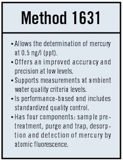

Advances in laboratory technique also are responsible for the current interest in mercury. Until recently, the lowest detection limit for mercury using an EPA-approved method was 0.2 g/l, using Method 245.1, which was issued in 1974. Its detection limit is one-fifth of ppb; therefore, any regulatory concern expressed as ppt was a moot point because it simply was not measurable.
The situation changed with the issuance of Method 1631 in 1999. Under Method 1631, a minimum level of 0.5 ng/l is achievable ," 400 times lower than the previous lowest detection limit. As a result, it is now possible, in a practical sense, to assess compliance with regulatory standards set at the ppt level.
Although most pretreatment permits currently held by industry are written at the ppb level and rely on Method 245.1 for measurement, the situation could change gradually. First guidance, then ordinances and, finally, pretreatment permits could be reissued to reflect the new lower level of achievable resolution for at least some of the mercury measurements.

Sources and Paths of Mercury in the Environment
Source: EPA, "Mercury Transport and Fate in Watersheds," 2000
