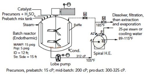

I’m a new process engineer hired to sort out a botched expansion. The plant tried to increase production by replacing our reliable pressurized batch reactor with a vessel with double the capacity. The new system (Figure 1) has operated for three months but isn’t performing well.
Viscous Batch Reactor
Figure 1. New reactor has twice the capacity of old, trouble-free unit, but poses all sorts of problems.
In the new setup, we boosted the agitation by a factor of 30% but kept the same heat exchanger because, according to corporate, it was oversized by a factor of two — now, the capacity matches the theoretical heat load. In addition, we increased the pump motor size and added a variable frequency drive — before the scale-up, the pump ran at the bottom of its curve. We retained the steam control valve; the cooling water is on an open-closed valve. We got rid of the bottom shell baffle and also the pre-batch tank, which our researchers believe we don’t need. We largely duplicated everything else. The previous plant owners left scant records, so we had to go by modeling. The designers didn’t bother talking to any of the operators; it was a hostile takeover so the old managers and engineers aren’t cooperating.
I inspected the old vessel in the boneyard and noticed the bottom baffle was added later; the code stamp agrees. The agitation nozzle appears to have been beefed up, perhaps afterwards as well. I checked the motor and it’s always been in the same bucket.
Currently, we’re having difficulty starting the reactor. We also are having trouble cooling it down between batches. The relief valve on the vessel has popped twice in the past month — an operator told me that never happened before. The valve sticks open when it relieves. The viscosity is lower than expected, about 180 cP, suggesting a reversal of the reaction or incomplete reaction, and the temperature spikes above 180°F at the reactor outlet. I had the operators reduce the batch size by 30% and we seem to be making good product with the process in control.
Further complicating my troubleshooting, the new management changed the batch ingredients. The surviving laboratory technician from the old days says the viscosities and densities are higher.
What was done wrong? How can we get this process producing at the desired rate?
