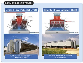

Common Cooling Towers
Figure 1. Plants typically rely on either an induced-draft crossflow (left) or counter-flow (right) design.
Figure 1 shows schematics of the two most common types of industrial cooling towers, induced-draft crossflow and induced-draft counter-flow. Both of these use air to remove heat from water fed into the tower.
Ambient temperature and humidity influence performance, and typically 65–90% of heat transfer in a cooling tower comes from evaporation of a small portion (1–3%) of the recirculating water. Thus, an underlying guideline for all cooling towers is to enhance air/water contact. In the beginning, this was accomplished through the use of splash fill — a series of wooden slats placed in a staggered formation below the water spray nozzles. As water impinges upon the slats, it breaks into small droplets that increase the surface area.
