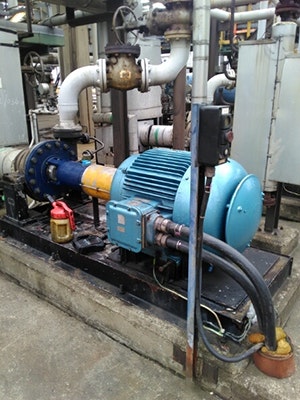

Figure 1. Compact unit can be attached to any type of rotating equipment

After an i-Alert2 sensor had been installed on the pump, the team continued to take manual readings as well. Over a period of several months, the handheld vibration devices hadn’t detected any issues. However, when data were retrieved from the i-Alert2 device, a different story emerged. Those data clearly showed that a series of high-vibration events had occurred in between the handheld readings. When the pump was dismantled, the bearings were found to be very badly damaged and near failure.
“Initially, the blame for the bearing failure was apportioned to the pump manufacturer,” comments the engineer. “But then, I sent the i-Alert2 data to my process engineers and said: ‘Can you just have a look at all these time stamps and tell me if there were any process upsets anywhere on this unit?’ And they came back and informed me that, indeed, there were a series of steam upsets. You see, part of the refinery process is to inject steam to help separate light ends and heavy ends of crude oil. The steam had dropped from 1,500 kg/hr (about 3,300 lb/hr) down to about 400 kg/hr (about 880 lb/hr). So there wasn’t sufficient heat to separate the products. This pump takes that separated product and pumps it away — but if there isn’t the steam to create the separation, there is no product for it to pump. So, it runs dry. And that’s what caused the hyper-vibration.
“So, based on this i-Alert2 data, we could actually quite clearly pinpoint that there was a defect resulting from the process upset. And we were able to notify the operations guys and say: ‘You need to keep on top of the steam,’ which solved the problem. It’s all to do with an external source of influence, that being the process obviously. And that’s where i-Alert2 sensor really helped us.”
The insight on the root cause of the problem was invaluable; the return on investment for this trial sensor was instantaneous.
Properly understanding and addressing this problem kept a hazardous situation from arising. The consequences of such an event can’t be overestimated in a refinery, stresses the engineer. “Ordinarily, the energy is being used to push the fluid through the pipework, but when the pump would start to run dry, it’s not. So the only thing it can do is be generated into heat. That’s why we get high temperatures in the casings, which aren’t good for the seals either. Then your fluid in the pump is getting hotter and hotter, and, if it does break out through the seals, you’ve possibly already exceeded ignition temperature and then you’re into a fire situation. So it’s very critical that we make sure that we run these pumps at the right levels. The i-Alert2 gives us the ability to see when we have an issue like this.”
