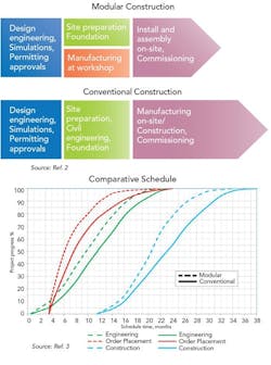

Modularized projects, if properly managed, can provide significantly compressed metrics. Figure 1 illustrates schedule savings typically achieved by a modularized project compared to a conventional stick-built one.
Comparing The Approaches
Figure 1. Modular construction, when feasible, offers compelling benefits.
