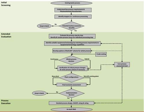

The methodology consists of three stages: initial screening, extended evaluation and process execution (Figure 1). The team already has applied the approach to three reactions with reasonably complex molecules.
Three-Stage Method
Figure 1. The approach reportedly gives insights quickly on the feasibility of converting a batch process into a continuous one. Source: A*STAR.
Initial screening focuses on understanding process requirements such as capacity needed, quality constraints, where the costs of the current process arise, and business drivers for change. This involves simple assessments (e.g., yes/no/maybe) of the physicochemical characteristics and behavior of the batch process to get a rough gauge of whether continuous processing potentially offers benefits. It also calls for a parallel evaluation of possible drawbacks of continuous processing as well as process issues that differ from those of batch operations. Such a screening can lead to a quick and justifiable decision on whether or not to consider a switch, say the researchers.
Continuous processes showing promise then undergo an extended evaluation, and those found worth pursuing enter the final, project execution stage. More details on the methodology appear in a recent article in Organic Process Research & Development.
