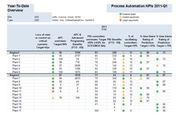

Performance Report
Figure 1. Summary page compares performance against process automation KPIs.

Using a combination of participation in the ARC Benchmarking Consortium and internal benchmarking, the company undertook an effort to compare process automation performance at its larger facilities. The goal was to understand if the automation assets at those facilities were comparable to peers, and to provide corroborating evidence of asset performance. This established a framework to move forward to gain the traction necessary to focus resources on areas NOVA Chemicals believes are important to improve automation asset performance. The KPIs help adjust focus to close identified gaps and deliver enhanced results and, therefore, better profitability. Figure 1 shows a summary page for a KPI report.
