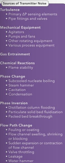

Table 1 lists sources of process noise found useful thus far. Of these, turbulence is most common. Such sources probably are self-evident, except perhaps for burner flame instability, which indicates incorrect air/fuel ratio or impending flame-out in furnaces and boilers.
Trying to identify the source or sources of noise at the beginning of a smart pressure transmitter problem-sensing application project is helpful. However, rigorous analysis isn't worth the time and effort. For example, noise reflected off internal surfaces can alternately reinforce or cancel itself out, depending upon conditions, thereby confusing analyses. Also, the more viscous a fluid is, the more it absorbs sound, which makes transmitter or testing equipment placement a guessing game.
It's best to attempt to identify generally expected trends of what the signal source is doing at any one time versus what the process is doing then or might do later. Detecting an incipient problem or failure is the ultimate goal. Thinking ahead helps speed the development of a testable hypothesis that can be instrumented-up and trended during normal and abnormal operations. It's all quite empirical.

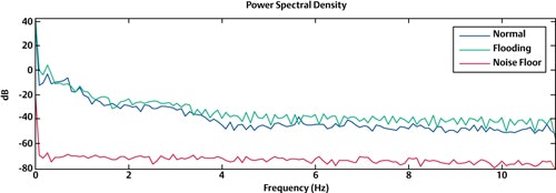

A power spectral density analysis can refine the sensing technique and check possible interference with the transmitter's regulatory function. Figure 5 shows bubble noise during normal and flooded conditions. Note that from 4 to 11 Hz the normal trace runs as much as 10 db quieter than the flooded one, making that range best for flooding detection. Also note that the two traces are quite flat and unspiked, indicating they are "weak white noise," i.e., noise that minimally affects the accuracy, reliability and repeatability of the regulatory signal.
 Figure 5. Biggest difference between flooding and normal noise occurs at 4–11 Hz.
