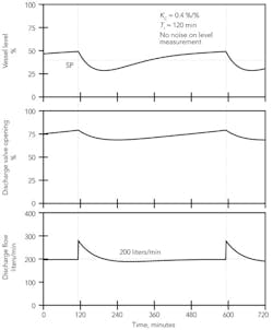

Figure 2. Switching filters increases discharge flow, spurring decrease in level.
Figure 2 illustrates the effect of switching the filters (at an interval of approximately 8 hours) for a constant feed rate of 200 liters/min and no noise on the level measurement. The discharge flow abruptly increases, which causes the level to decrease. The subsequent drop in discharge flow stems partly from the response of the level controller and partly from the increased resistance to flow within the filter. When the level controller is conservatively tuned, equilibrium conditions aren't established prior to the next switch.

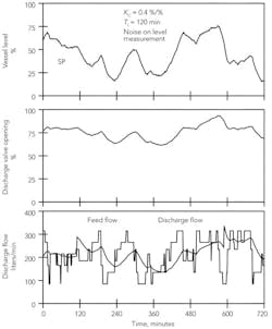

Figure 3 illustrates the effect of switching the filters for a varying feed rate and noise on the level measurement. On each switch of the filters, the discharge flow sharply rises. This is apparent in the trend of the discharge flow but not in the plots of vessel level or level controller output. Variability of the feed to the vessel causes comparable changes in the magnitude of discharge flow during normal operations. However, the change on switching the filters is sudden. For most unit operations, abrupt changes to the feed are major upsets; the same change over a longer time period has fewer consequences.

Figure 3. Higher discharge flow after switching filters isn't apparent from vessel level.

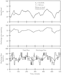

Figure 5 presents the performance of the cascade configuration for a varying feed rate and noise on the level measurement. A controller gain of 0.4 %/% leads to occasional trips on low level, making a gain of 0.6 %/% more appropriate.
On switching the filters, an abrupt decrease occurs in the discharge valve opening. On the time frame of the trend in Figure 5, the response of the flow controller is instantaneous. However, there's no effect on discharge flow. (The decreased valve opening merely compensates for the lower pressure drop across the filters.) In the cascade configuration, the flow controller completely isolates the level controller from any consequences from switching the filters.

Figure 5. Flow controller isolates level controller from any consequences when filters are switched.
