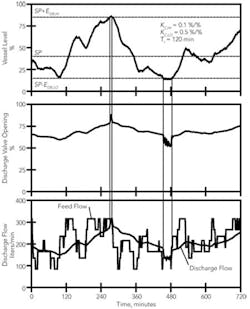

 Figure 6. The control equation provides low sensitivity above the set point.
The previous article covered the response of the standard PI control equation for a controller gain of 0.4 %/% and a reset time of 120 min. The control equation provided a relatively smooth discharge flow without initiating any process trips on high level or low level.
Figure 4 shows the performance of the error gap control equation for a controller gain of 0.2 %/% within the gap and 10 %/% outside the gap. The discharge flow is even smoother. However, the vessel level occasionally makes brief excursions outside the gap — once above the upper deadband and once below the lower deadband. On each excursion the gain abruptly increases from 0.2 %/% to 10 %/%. This causes both the controller output and the discharge flow to change rapidly.
Rapid changes in the discharge flow have the desired effect of avoiding a process trip on high or low level. However, this is at the expense of an upset to the downstream unit. A process may tolerate occasional occurrences, especially if they are associated with a major upset or other abnormal event. However, if such excursions happen regularly you must increase the sensitivity within the gap.

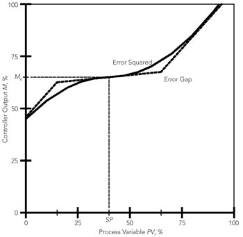

The term "signed error squared" (E2 < 0 if E < 0) more accurately reflects the nature of the relationship. To achieve this, we use |E| E in lieu of E2.
Figure 5 illustrates the relationship for the proportional mode. The dashed line is the error gap relationship from Figure 1. The two relationships are very similar, which suggests that if one will work, the other probably also will.

Whereas the sensitivity of the error gap equation increases abruptly when the control error crosses the error deadband, the sensitivity of the error squared equation increases linearly with the control error.

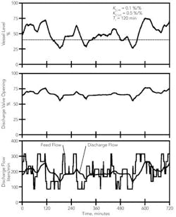

Figure 6 illustrates the performance of the error squared control equation for KC,HI= 0.1 %/% and KC,LO = 0.5 %/%. The low sensitivity above the set point makes the controller more tolerant of errors when PV > SP. Consequently, the vessel level is above its set point more than it is below it. Because of the higher sensitivity below the set point, rather rapid decreases occur in the controller output and the discharge flow when the vessel level drops below its set point. Reducing KC,LO would slow these changes — but would not ensure that the control valve is closed should the vessel level drop to the location of the low-level switch.
