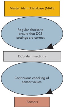

Figure 1 - MAD’s Role: Use of a Master Alarm Database
provides an effective way to enforce alarm parameters.
2. Use of a Master Alarm Database. A MAD is the master repository for the alarm configuration parameters (Figure 1). Some vendors (e.g., Honeywell) now include operating envelope data in an expanded database known as the Master Boundary Database. The addition of operating envelope information is significant because well-designed alarms often relate to one or more of the many limits that define the operating envelope for safe and efficient operation. Use of a MAD facilitates several different functions: • Enforcing alarm parameters. This activity overwrites alarm parameters on the DCS when these are found to differ from the values stored in the MAD. It prevents the alarm system from being used when operators (or others) have changed the values of parameters (such as alarm priorities or alarm limits) — perhaps on a temporary basis — and not restored the as-designed values afterwards; • Tracking enforcements. This enables identifying alarm parameters regularly being changed and updating them, if needed, to more appropriate values; • Logging all changes to the MAD. This clarifies why and when changes were made and who made them; • Providing online operator help. Information can include the likely cause of an alarm, the consequences of no action, the action itself, and the time available for operators response; and• Linking alarms to the relevant operating-envelope values. Reasons for the alarm limits become much more transparent, making any changes in alarm values that violate the operating envelope — which could have serious implications — less likely. The benefits of using a MAD are that the plant continues to operate using the parameters agreed upon during rationalization. If some parameters are changed on a regular basis for justifiable reasons, the alarms can be reviewed again and the MAD updated to include the modified values. The use of a MAD is often regarded as critical to maintaining the alarm system’s integrity. This demands its implementation as an integrated part of the alarm system as well as robustness because its enforcement and operator-help functions must have high availability. It’s not simply an offline tool with DCS access but needs integrated functionality that can limit the loading on the DCS. Most sites currently don’t utilize a MAD — so this means for improvement again has considerable potential. 3. Improvements to the Human Machine Interface. Human factors issues have often been neglected. However, the whole control center environment affects operator effectiveness. At a more detailed level, the HMI can significantly impact alarm management [9].
