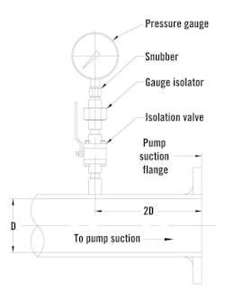

Fig. 1 illustrates the system that can be used to mount the test gauges. These gauges should be kept in calibration, clearly marked as test gauges only, and stored in a clean restricted-access area such as a locked maintenance cabinet.
Figure 1. Test Gauge Setup
Every facility should have high-quality gauges dedicated solely to trouble-shooting and performance verification.
The pressure snubber protects the gauge from process pressure spikes. If you buy a high-quality gauge, then spend an extra $15 to protect it from spikes. A gauge isolator also is recommended. It can prevent gauge or process contamination. It also allows the use of less noble metallurgy for the gauge, which might represent a significant cost savings if your process requires exotic metallurgy. The valve is essential for the isolation of the test gauges and must meet all process fire and safety requirements.
You may take pressure measurements at any location close to the pump. Many process pumps have tapped pressure connections at the suction and discharge flanges. For performance verification purposes, these will suffice.
If you have to install taps for the pressure gauges, the Hydraulic Institute standards require the suction and discharge pressure tap locations to be two diameters of straight pipe from the pump suction and discharge. Locate the taps as close as possible to locations specified in the Hydraulic Institute Standards to get the most accurate results.

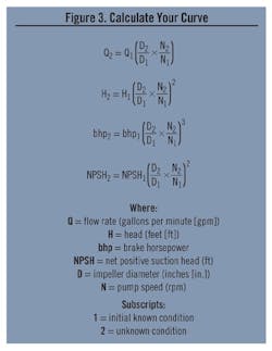

If a curve is not available for the correct operating speed or if you cannot obtain a curve for your trim diameter, you can use affinity laws to approximate pump performance. Using data from an existing performance curve at a different speed or diameter, you can calculate the data for the curve you need. The formulas are shown in Fig. 3. They can be used to change diameter, speed or both. The results of these calculations are approximations of the actual values. The affinity laws assume that efficiency is constant for small changes in speed or diameter.
A free downloadable Microsoft Excel spreadsheet that does the conversions for you can be accessed at www.mechtronixeng.com. Many existing software programs also will handle the affinity law calculations. Many manufacturers provide data in an electronic format, either in a proprietary program or commercially available software. One example is Pump-Flo from Engineered Software (www.pump-flo.com).
These programs often allow the user to adjust the performance curve for changes in impeller diameter, speed, viscosity, specific gravity, etc. The user then can plot a custom performance curve for the application.

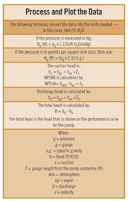

First, calculate the NPSHA:
hgs = [23.5 in. Hg x 1.131(ft H2O/in. Hg)] = 26.58 ft
hs = -26.58 + 1.69 + 0.5 = -24.39 ft
hvp = (0.65 x 2.31)/1.221 = 1.23 ft
hatm = 33.94 ft
Therefore:
NPSHA = 33.94 - 1.23 -24.39 = 8.32 ft
Then we calculate the discharge head:
hgd = (26 x 2.31)/1.221 = 49.19 ft
Therefore:
hd = 49.19 + 8.18 + 1 = 58.37 ft
Total Head:
H = 58.37 - (-24.39) = 82.76 ft

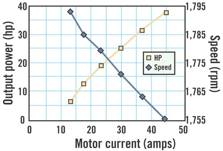

From the motor performance curve (Fig. 4) and the amperage data, you can see that the pump is operating at less power than predicted by the pump performance curve (Fig. 2).
Figure 4. Motor Performance Curve
The motor curve shows that the pump actually is operating at less power than the pump performance curve (Fig.2) predicts.
A performance curve reading at 17.5 amps corresponds to approximately 11.5 hp vs. a performance curve expectation of approximately 14 brake horsepower (BHP). Plotting the flow rate and total head on the performance curve shows the pump is operating well off the stated performance curve. The NPSHA of 8.32 ft is well below the 10.7 ft required by the pump at 240 gpm. This performance reduction likely is the result of cavitation.
Many users do not believe their pumps are cavitating because they cannot hear the characteristic "gravel" sound in the pump. After the performance breaks down, the pump might go into full-sheet cavitation. In this extreme form of cavitation, the entire vane becomes enveloped with vapor bubbles displacing a large volume of liquid. When this severe form of cavitation happens, the noise often drops off because the bubbles do not collapse until they are far downstream. Many users have no idea the pump is cavitating.
The reduction in horsepower also is a clue that the pump is pumping two-phase flow (vapor bubbles and liquid). The fluid density reduction causes a reduction in horsepower demand.
