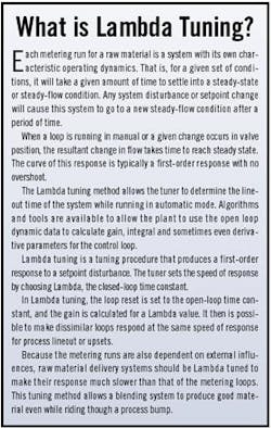

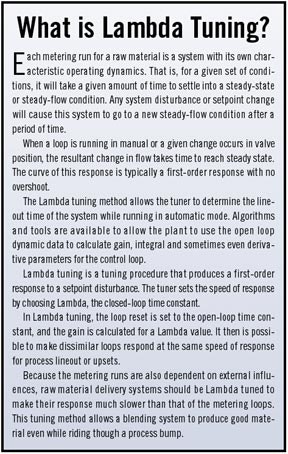

Loop tuning of product addition should be optimized for operational conditions. Lambda tuning techniques are a good fit here because they make many loops with dissimilar physical response characteristics behave the same. If all metering runs respond the same to process upsets, the benefits to product quality are obvious. See the sidebar for more information on this tuning method.

This example shows Lambda-tuned multiple loops that have the same effective settling time. Two setpoint changes are shown. The desired ratios are held relatively constant and good product is made during the transition to the new system setpoints.
