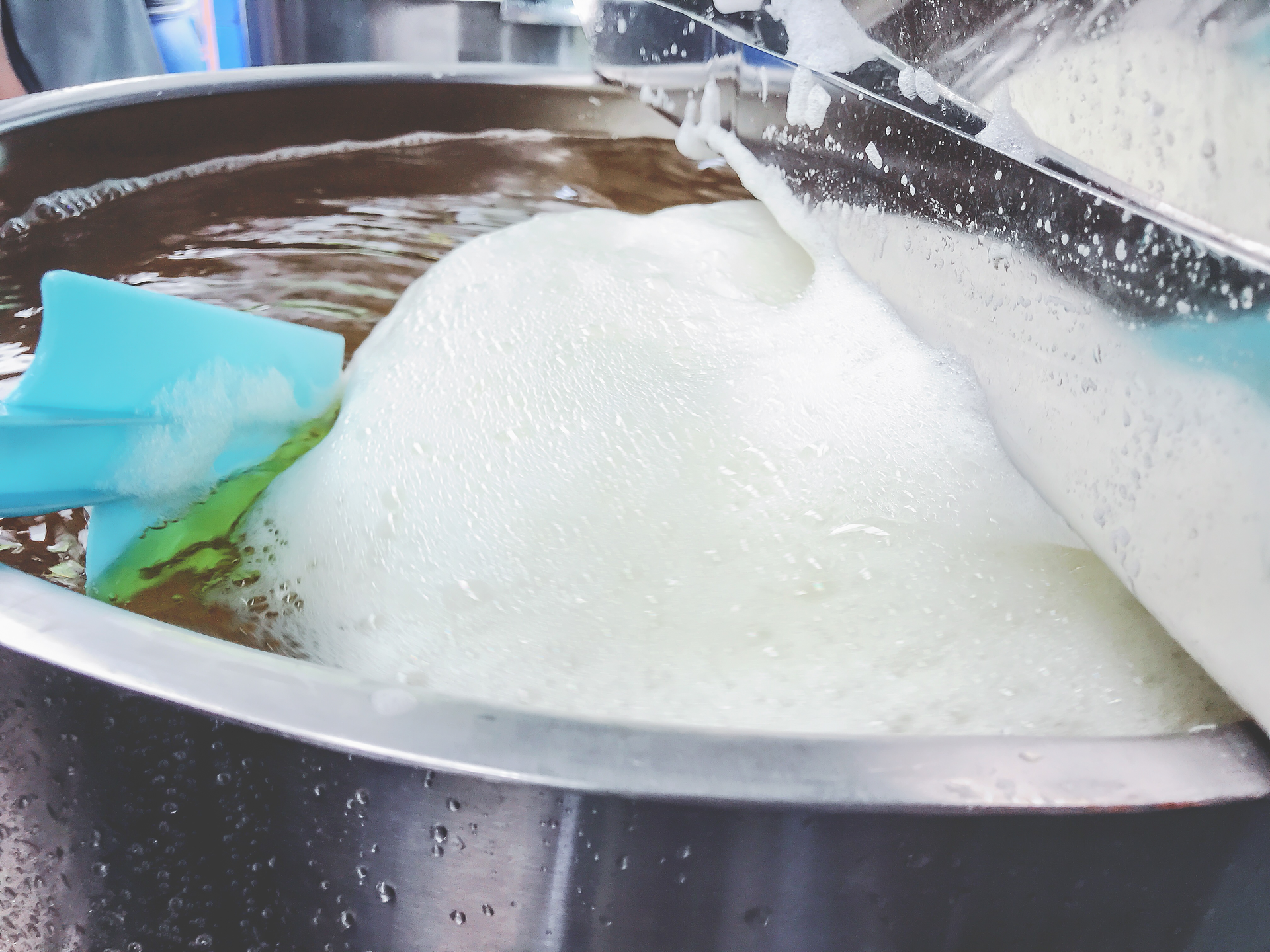

In economics, “froth” is bad news. It means stock prices are well beyond their actual value and a bubble is about to burst. We deal with a somewhat similar problem in chemical storage. Excessive foaming of liquids impacts storage capacity, taking up precious space and leaving companies with potentially costly remedies.
The accumulation of foam in chemical storage, referred to going forward as “foam inventory,” is the result of foam creation competing with foam decay.
foam inventory = foam creation - foam destruction (decay)
