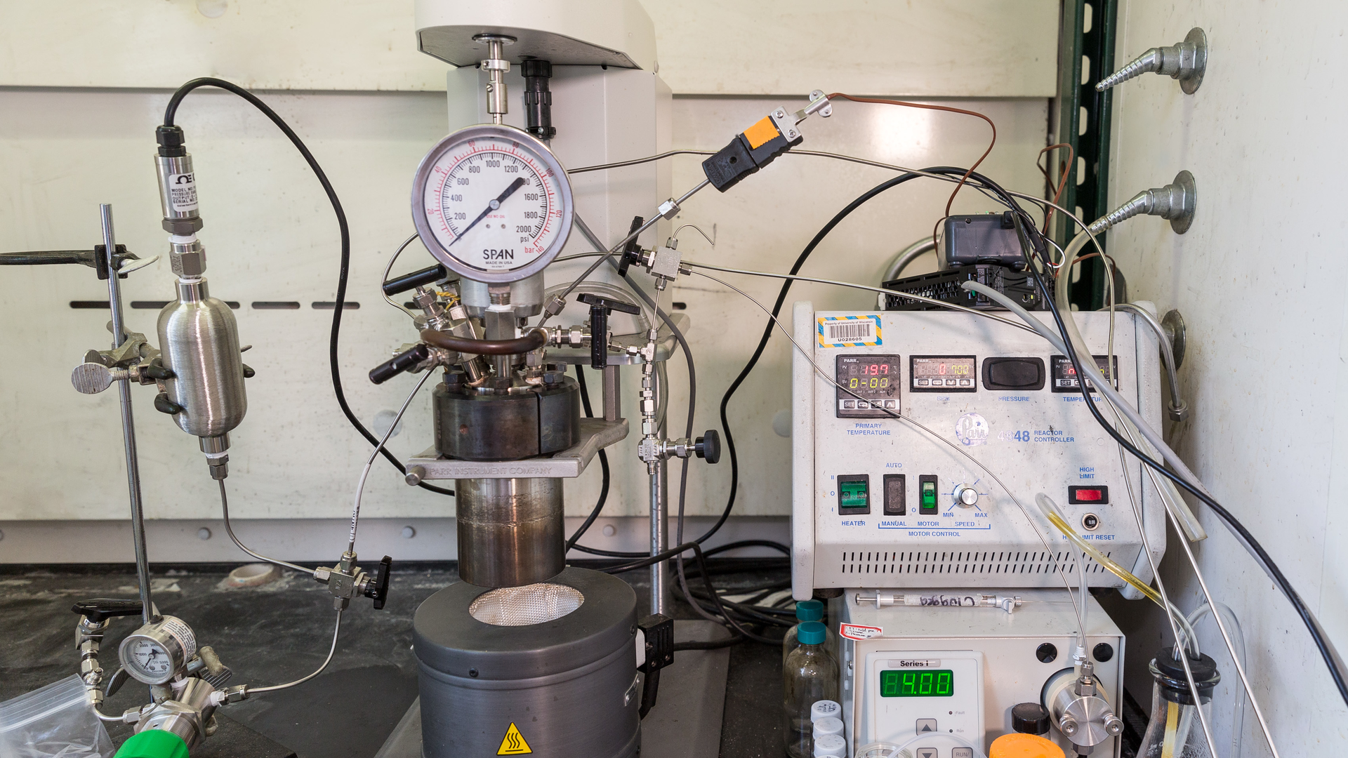

A new technique developed by chemical engineers at the University of Wisconsin–Madison converts low-value plastic waste into high-value products. They use several existing chemical processes to achieve their results.
First up is pyrolysis. The resulting oil contains large amounts of olefins, which are
recovered and used in a much less energy-intensive homogenous hydroformylation catalysis process. This converts olefins into aldehydes, which can then be further reduced into important industrial alcohols.
“We’re really excited about the implications of this technology,” says George Huber, professor of chemical and biological engineering who led the work and who also directs the Department of Energy-funded Center for the Chemical Upcycling of Waste Plastics. “It’s a platform technology to upgrade plastic waste using hydroformylation chemistry,” he adds.
Postdoctoral research associate Houqian Li believes the technique could provide a more sustainable and lucrative way for the industry to deal with pyrolysis oil, which is often run through steam crackers to produce low-value compounds (Figure 2).
“Currently, these companies don’t have a really good approach to upgrade the pyrolysis oil,” says Li. “In this case, we can get high-value alcohols worth $1,200 to $6,000 per ton from waste plastics, which are only worth about $100 per ton. In addition, this process uses existing technology and techniques. It’s relatively easy to scale up.”
The research has spawned many follow-up opportunities, says Li. “We are producing samples for testing as surfactants to compare their properties with those of the surfactants generated from fossil feedstocks,” he explains. “We also plan to explore the approaches to tune the carbon distribution of the products generated from this route.”
This testing will involve different waste plastic feedstocks to adjust the branching properties of the final products, varying the reaction conditions to influence both carbon distribution and the functionalities of the chemicals produced, plus manipulating the parameters and gases used in the pyrolysis step to make this step more selective and energy efficient.
