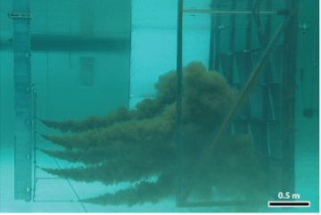

Argonne used SIS and chemical grafting of an oleophilic monolayer on polyurethane foam to create Oleo Sponge. Oleo Sponge is a reusable sorbent that rapidly and efficiently separates oil from water. Argonne qualified Oleo Sponge at the Ohmsett National Oil Spill Response Research and Renewable Energy Test Facility in New Jersey by separating crude oil from seawater under winter conditions (Figure 3).
