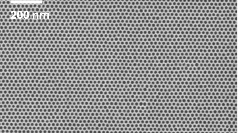

Seth B Darling/Argonne National Laboratory
pore_image

Researchers at Argonne National Laboratory (ANL), Lemont, Illinois, have achieved ultra-high-resolution solute separation using custom-fabricated, defect-free silicon nitride isoporous membranes.
Commercial membranes mostly have pore sizes that aren’t consistent, and so are known as polydisperse. With such membranes, it is nearly impossible to do a sharp separation of materials as different sizes of solutes can fit through different pores.
"Essentially all commercial membranes, all membranes that are actually used for anything, have a wide range of pore sizes — little pores, medium pores and big pores," said Seth Darling, head of the Advanced Materials for Energy Water Systems (AMEWS) Center at ANL.
Separation by membranes where all the pores are the same size, in ANL’s case 17.8 ± 1.3 nm, traditionally is described by hindered transport theory. Here, convective and diffusive hindrance prevents solutes smaller than the pore from passing through.
The ANL researchers have developed a 12-step fabrication process which starts with a silicon wafer coated on both sides with 100 nm of silicon nitride. They combine the finished membrane with a recirculating feed to increase the opportunity for interactions between solutes and the isoporous array.
Results described in a recent issue of Nature Water (DOI: 10.1038/s44221-024-00252-3) show the membrane completely rejects solutes with greater size than the pore size while effectively allowing smaller solutes to permeate through it.
With this traditional hurdle overcome and a steeper size-selective rejection curve achieved, the ANL researchers believe there’s new promise for unprecedented membrane separations through judicious process design and extremely tight pore-size distributions (Figure 1).
