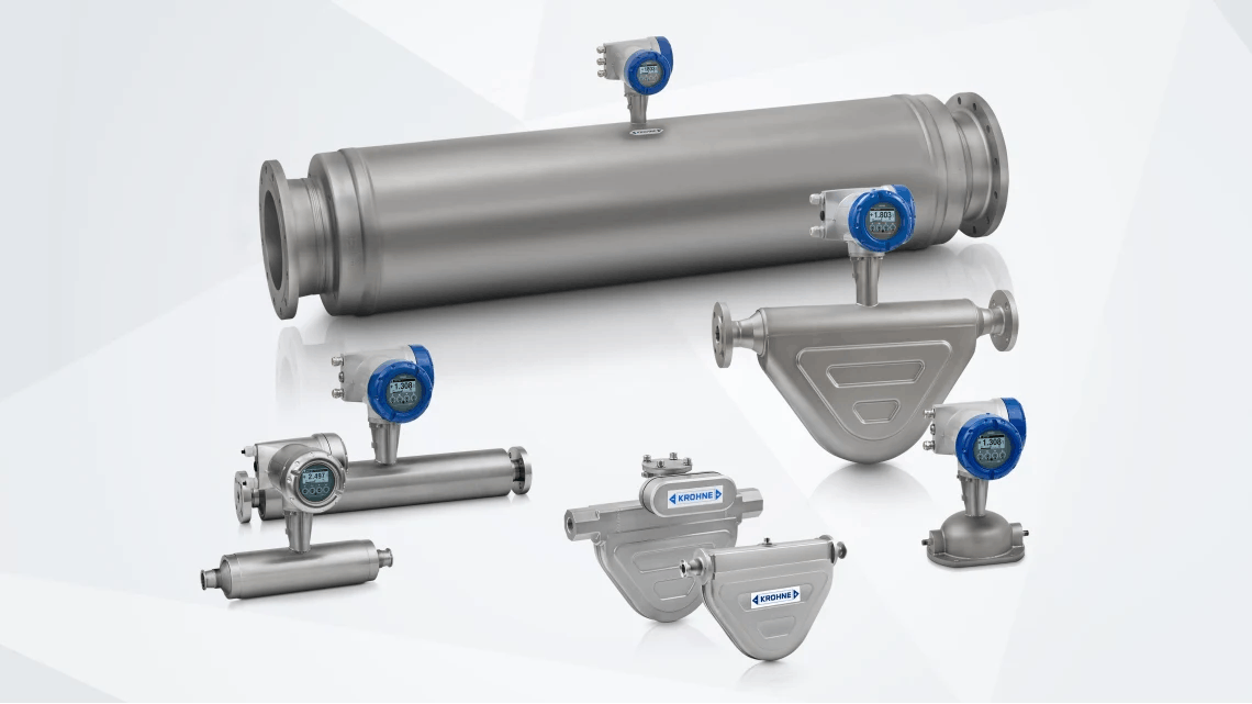

Q: Are all Coriolis meters alike?
A: There are many different flavors of Coriolis meters from a variety of manufacturers, and that variety means there’s one out there for just about every application.
Q:  What benefits do Coriolis meters offer, and why does it matter?
A: Coriolis meters are also known as mass meters — and that is a huge benefit. Most flow meters measure flow velocity, and there are a few different ways that they do that. To get to mass, you can make assumptions and do calculations that are generally very good. Now, I don't mean to imply that volumetric flow meters aren't as good or don't have their place; they most certainly do. But when you're dealing with things like chemical reactions that are typically mass-based, if you can cut out some of those calculations and assumptions because your primary measurement is mass flow, that helps. Mass is conserved, volume is not.
Changes in temperature and pressure may introduce unexpected errors. While the main benefit of Coriolis meters is that they directly measure mass flow, that's not all they measure. They are multivariable meters, so you get a live mass flow as well as an independent inline-density measurement, which is not easy. You also get temperature measured directly from the meter. So, with one installation point, you get various useful and accurate measurements.
I would refer to those as front-end measurements. But Coriolis meters also offer back-end measurements like tube frequency, drive level or drive gain, and sensory amplitudes.

A: KROHNE was the first manufacturer to figure out how to make a straight tube meter. A straight tube design is a fantastic option if you're dealing with something very viscous. As mentioned earlier, it is also a space saver.
We have various straight tube options: single straight tubes and multi-straight tubes. We can make them from a quarter of an inch up to 16 inches, the highest capacity Coriolis meter on the market today.
