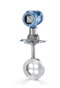

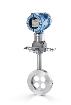

David: All flow technologies bring their own strengths for a given application. DP flow is the oldest flow technology — it's simple. You create a restriction in the pipe and measure the change in pressure. But there are other technologies like Coriolis for mass flow with no moving parts, or ultrasonic mag meters with no pressure drop. With DP flow specifically, we have a four-hole conditioning plate that significantly reduces the straight run you need and takes up a very small profile on the line. This reduces piping costs and saves space. Enhanced diagnostics on transmitters support proactive maintenance by detecting process aberrations or entrained water in electronics or impulse tubes. And our upcoming 4051S transmitter offers a 28-to-1 flow turndown. Typically, sites stock multiple transmitters in the warehouse for turnarounds or shutdowns, but with higher flow turndown, you can eliminate stockouts by standardizing on one.
