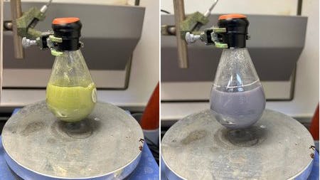

Credit: Caltech/Chungkeun Shin
Different stages of a chemical reaction with the samarium diiodide reagent.

Caltech researchers have developed a method to scale up the use of samarium diiodide, a valuable reagent in pharmaceutical synthesis. Previously limited to laboratory use, the new technique allows the reagent to recycle itself within a single reaction, according to a news release from Caltech.
"The reagent is air sensitive, so you often have to prepare the solution fresh, right before the reaction," says Caltech graduate student Chungkeun Shin, who works in the lab of Sarah Reisman, Bren Professor of Chemistry and the Norman Davidson Leadership Chair of Caltech's Division of Chemistry and Chemical Engineering. "And we often have to use large amounts of it, even in small reactions, so it's not practical for running industrial-scale reactions."
The key breakthrough addresses the formation of a stubborn samarium-oxygen bond that renders the reagent inactive. Using a mild acid, researchers can cleave this bond, converting the bound oxygen into an alcohol and freeing the samarium for reuse. This process eliminates the need for large amounts of solvents and fresh preparations, making industrial-scale reactions more feasible.
