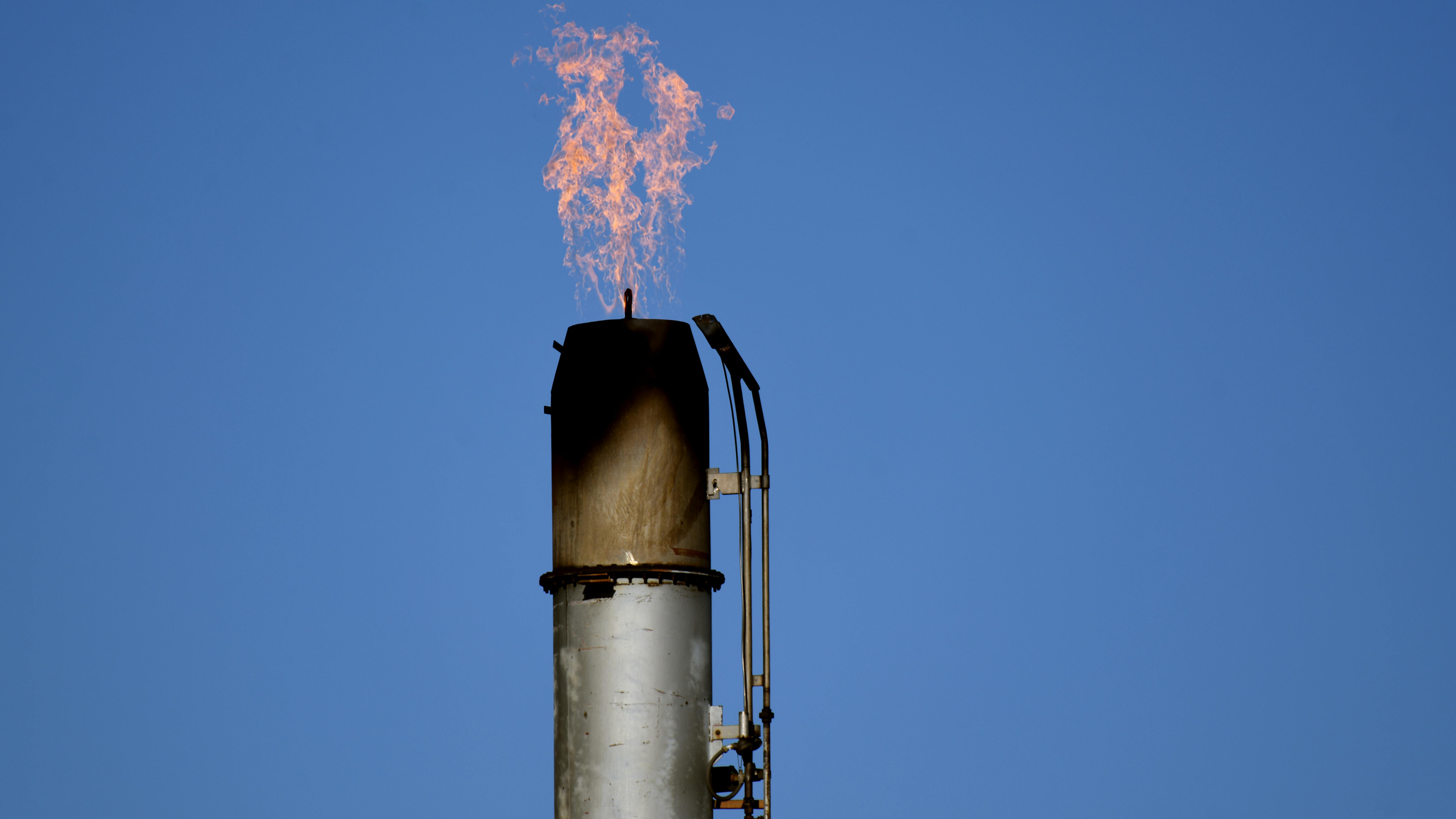

Gas flares into the sky at the Suncor Energy oil refinery in Commerce City, Colorado, on Wednesday, July 26, 2023.

Suncor Energy is planning a two-year construction project at its Commerce City oil refinery to tear down a 75-year-old flare stack that often sends flames flickering from the top, and reconnect the pipes that funnel excess gases to a newer, more efficient flare on site.
The $16 million project is scheduled to start later this year, pending approval from the Colorado Department of Public Health and Environment.
The work would dismantle the 100-foot-tall flare stack, often called a smoke stack by the general public, built in 1950 as part of what is now called Plant 1. The gases that are burned by that flare will be rerouted to the refinery’s taller gasoline benzene reduction flare, which was built in 2012, said April Maestas, engineering director at the Commerce City refinery.
