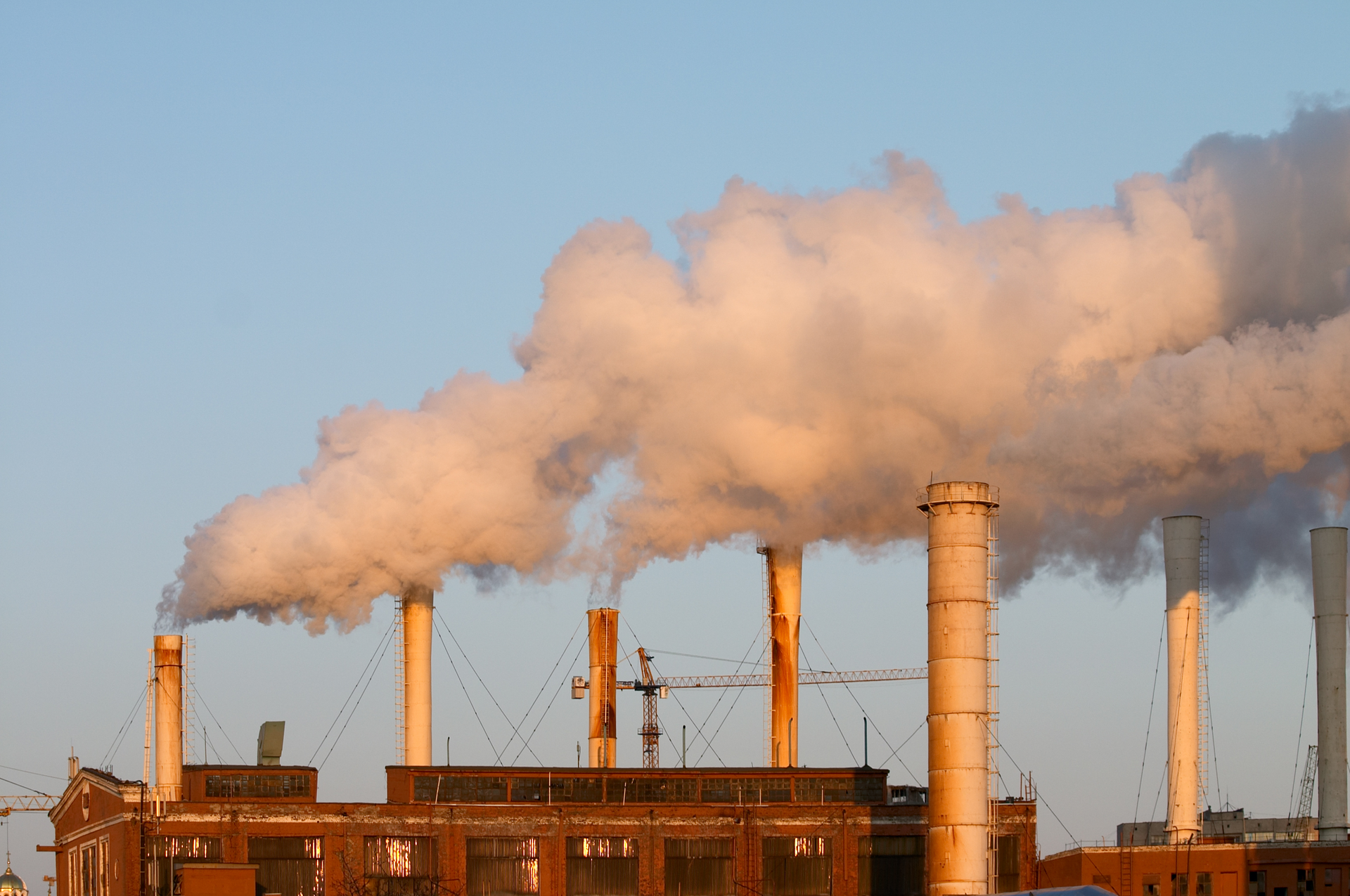

When I started in industry, the number of smokestacks in the area signaled prosperity. Before long, those smokestacks had to be cleaned up. Nowadays, at the end of most processes is some kind of cleanup device to control costs, protect the environment or sustain operations. Think of it as an extension of the process design. It may involve a recycling process or even the development of a new product. The operations cover all the same solids-processing steps we use in process design but often at very low concentrations of solids. This makes for a challenging situation. In air-pollution control, the particles can be sub-micron, with only a few micrograms per cubic meter allowed to be released. For water quality issues, we may draw in water for a cooling process and return it cleaner than what was received.
The number of smokestacks in the area signaled prosperity.
