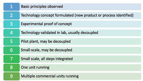

The National Aeronautics and Space Administration formalized the path of technology development in the 1970s by defining nine technology readiness levels (TRLs). Figure 1 shows my adaptation that includes definitions more suited to the process industries. The break point between TRL levels should match step changes in operation where many problems occur. Technology should move to the next TRL level only after achieving success at the current level.
Technology Readiness Level for a Process Plant
Figure 1. A successful technology typically goes through nine levels of development.
Only a miniscule fraction of the ideas that start at TRL 1 actually ever get to TRL 9. So, here, we’ll focus on technology that’s promising enough to have reached TRL 5 and what’s involved in moving it to TRL 9. These are the levels most likely to involve engineers experienced in commercial plants.
