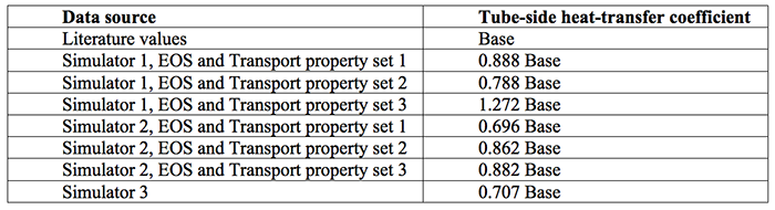

Table 1. The simulator results differed significantly from the one obtained via literature values.
Now, let’s examine the simulator results for the propylene-glycol/water system compared to using the literature values for the fluid properties. Table 1 shows the variation in calculated heat-transfer coefficient.
The base tube-side heat-transfer coefficient came from using literature values provided by the fluid vendor for the properties of the mixture. These were checked by curve-fitting values from the open literature that bracketed the 50/50 composition range. The property values from the vendor and in the open literature matched well.
In comparison, the closest simulator values for system properties result in heat-transfer coefficients more than 10% away from the base value. In some cases, deviations reached about 30%.
Table 2 gives ranges of heat-transfer coefficients for each of the properties. These numbers don’t add up to the ones in Table 1 because some deviations offset each other. Table 2 shows that density errors aren’t that significant but deviations in estimated specific heat are — and that thermal conductivity and viscosity differences are most important.

The film coefficient is only one part of the heat-transfer evaluation. The total deviation will be less than that shown here but errors of up to 30% can lead to significant misses when evaluating fouling.
What’s interesting is that the simulators mostly predicted lower heat-transfer rates than those using the literature values for the fluid properties. The simulator physical-property estimates lead to a lower predicted fouling than that derived via the vendor-supplied physical properties.
