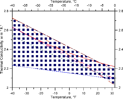

Ice Thermal Conductivity
Figure 1. Broad variation in values reported in the literature can lead to confusion.
Figure 1 presents a range of reported values from different sources for the thermal conductivity of ice. At -40°F, the highest and lowest cited values differ by about 23%!
This certainly is enough of a difference to worry about if you are looking at food processing or Arctic engineering work on pipelines to prevent permafrost melting. However, does it really matter when it comes to the issue of ice insulating pipes in a refrigerated or cryogenic process plant? Not really — because the variance pales compared to the difference between the thermal conductivity of ice versus that of insulation materials.

I created Figure 1 by reviewing seven datasets. Each plot represents the original correlations developed for the particular dataset. These correlations date back to 1922. Often, engineers don’t go back to the original work when verifying correlation data ranges but instead depend upon later summaries of the correlations.
Finding and verifying the data showed that one of the most recent summaries had two major flaws. First, the correlation given in the summary used the wrong temperature units; the authors had mixed up Kelvin with degrees Centigrade. Second, the summary transposed the intercept and slope values of another correlation for a linear curve fit. This summary didn’t appear in an Internet blog but in a reputable peer-reviewed journal.
