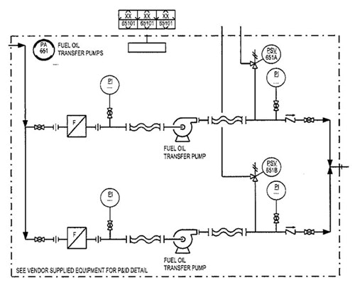

Process And Instrumentation Diagram
Figure 1. Such a drawing should clearly indicate major equipment boundaries for vendor-supplied systems and skids.
However, P&IDs sometimes fall short of the optimal level of detail in two key areas:
1. Major equipment boundaries for vendor, OEM-supplied systems and skids (Figure 1); and
2. Utility and support systems requirements.
Identification of major equipment and system boundaries is imperative because the team essentially is carving out a portion of the process and allocating the responsibility or scope to another entity. If all the pieces of the process puzzle are to fit, these boundaries must be precisely defined for the suppliers of each piece. This is particularly important for the successful integration of the process automation and other systems. Figure 2 shows the interdependency of the systems typically deployed to support a chemical process. Toward the end of the process definition phase, the team can start to develop equipment and subsystem specifications based on established process boundaries and requirements. In addition to the mechanical and process requirements, these specifications must include requirements for the control system, instrumentation, overall process integration strategy and the vendors’ role during process startup and commissioning.
Similarly, the process definition team must address the requirements of the utility and support system on the P&IDs, so the detail design team can clearly understand how to quantify and meet those requirements for the various pumps, motors, instruments and other equipment. This demands a significant level of detail, especially when, as is typical, a portion of the design is subcontracted — for example, piping tie points and process parameters at those tie points between the core process and utilities, such as compressed air, steam, cooling water, process water pretreatment and wastewater treatment systems.
