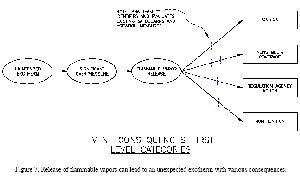

The Event-Tree side of the Bow-Tie diagram is used to identify and evaluate credible outcome scenarios. A variety of consequences can be addressed including, injury, damage to equipment, environmental consequences, production outage, company reputation, or other criteria of concern. Safeguard measures that prevent, or mitigate, consequences are identified and depicted by vertical lines. The Event Tree side of the Bow-Tie diagram has the capability to illustrate various consequences outcomes based on the presence, or effectiveness, of the safeguard measures.
As previously mentioned, selection of the top event is critical for success. For this illustrative example, the PHA team identified three sequential events that occur (Figure 2). To be significant, an unintended exotherm must progress to a situation that results in loss of containment (release of process material to the atmosphere). There are safeguards that prevent an unintended exotherm event from developing into a loss of containment incident. For example, if the reactor emergency cooling, or quench system, function adequately, a release to the atmosphere could be avoided.
Release of flammable vapors could result in one, or more, of four outcomes (Figure 7):
Event consequences, first level categories
Figure 7: Click to enlarge
• ignition (and its subsequent consequences)
• non-ignition
• news media coverage
• regulatory agency action
The PHA team identified five existing safeguard measures that prevent or mitigate ignition (Figure 8):
