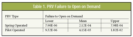

PRVs boast relatively high integrity, as long as they are properly sized, located, inspected and maintained. Table 1 summarizes reliability data for a single-valve relief system, as published in "Guidelines for Process Equipment Reliability Data" [3]. It shows substantial uncertainty in the failure to open on demand. Reactive chemicals and their associated processes present complex scenarios for PRV design. Small deviations in reactant concentration or reaction conditions can put the reaction on a path that the process design, control system and operator procedures cannot adequately manage. Unfortunately, many PRVs are improperly sized for reactive processes, because relief rate calculations often are based on a design and operational envelope that ignores potential reaction paths that are not well understood.

    The SRS also includes documentation of the safety integrity requirements, including the Safety Integrity Level (SIL) and anticipated testing interval. At a minimum, the integrity of the HIPS should equal that of a PRV. The data in Table 1 implies that the HIPS should be designed to meet either SIL-2 or SIL-3, depending upon the type of PRV. However, bear in mind that the failure modes of a PRV and the HIPS differ. A PRV that fails to operate at the set pressure nevertheless may operate at a higher pressure, whereas HIPS is more likely to fail completely. The failure-to-open-on-demand uncertainty, coupled with the difference in the failure modes, results in the majority of users setting an SIL-3 target for the HIPS.
