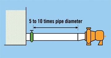

Rule No. 4
Provide the suction side with a straight run of pipe, in a length equivalent to five to 10 times the diameter of that pipe, between the suction reducer and the first obstruction in the line. For reliable pump operation, liquid must arrive at the impeller eye with the right pressure and smooth uniform flow. Achieving this depends a great deal upon the suction piping design. The arrangement shown in Figure 3 will ensure the delivery of a uniform flow of liquid to the eye of the impeller and provide that optimum suction condition.
Note that this layout contradicts the information given in most IOM manuals that the suction piping should be "as short as possible." This arrangement also supports Rule No. 1 and should eliminate the practice of squeezing the pump into a corner without any consideration for fluid flow patterns or physical accessibility.
