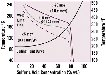

H2SO4: Watch the welds
One of zirconium's first commercial chemical processing applications was in sulfuric acid environments. The metal is one of few materials that resists the acid at concentrations up to 70 percent, and above boiling temperatures. Recently, zirconium equipment has found increased use in processes used to make methyl methcrylate and alcohols, in certain organic synthesis reactions, as well as in sulfuric acid recovery systems and pickle tank heaters. Its use in grid coils for sulfuric acid pickle baths has allowed a more efficient, environmentally safer method of heating acid.
Despite its strong resistance (see Fig. 3), the metal's welds and heat-affected zones (HAZs) are vulnerable to corrosion at higher acid concentrations. This susceptibility is due to formation of continuous networks of second-phase intermetallic compounds, which precipitate in alpha grain boundaries as the weld cools. Heating the welds at 630-780 Degrees C for 30 minutes to two hours will generally improve corrosion resistance in the weld and HAZ.
Figure 2. Zirconium in H2SO4: Heat Treatment Relieves Weld Worries
Zirconium is vulnerable to attack at high sulfuric acid concentrations, as precipitates form within the weld. Heat treatment will improve resistance.
